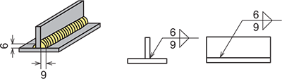

Fillet welds with different
leg length on both sides
Fillet welds with 6−mm leg
