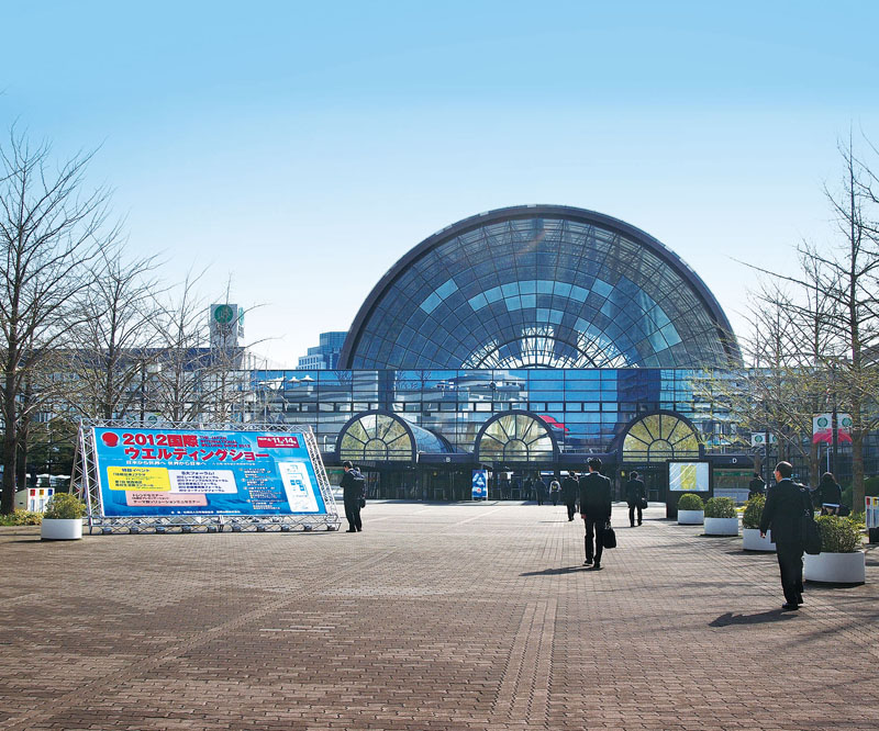

 The Japan International Welding Show 2012, one of the world’s three major welding shows, was held at the international exhibition center, Intex Osaka, from April 11 to 14. According to the show’s organizer, as many as 66,697 visitors, including 2,291 from overseas, attended the four-day event that coincided with the blooming of the cherry blossoms in Osaka and elsewhere in Japan.

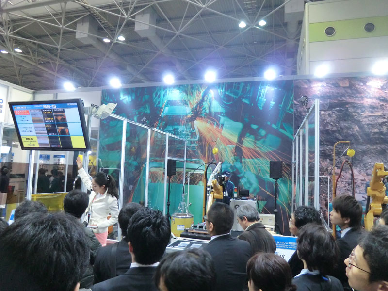

 The third eye-catcher was the MX-MIG process for thin plate welding, which uses a dedicated FCW with a pure Ar shielding gas to create exquisite bead appearance and ultra-low spatter. In lap welding, this process can produce a regular weld bead with smooth weld toes, thereby improving the fatigue strength of the weld joint.
ARCMAN™-GS robot with the torch-integrated wrist demonstrates the REGARC™ process installed in SENSARC™ AB500 power source.
Many visitors listen to the guide demonstrating MX-MIG for sheet metal welding.
