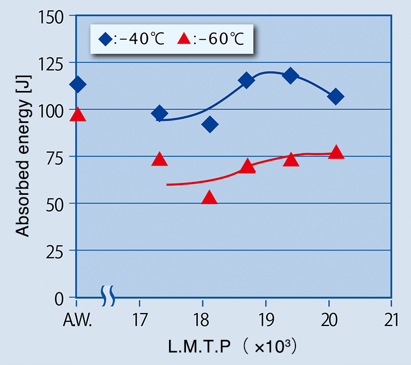

Figures 1 and 2 show the relationship between PWHT conditions and mechanical properties of the deposited metal.

Figure 2: Relationship between absorbed energy and LMTP

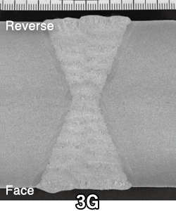

A butt joint weld test was conducted under the conditions shown in Table 2.
Table 2: Welding conditions
Welding wire DW-A62LSR (1.2mmΦ)
Base metal TS610MPa class steel (60mm thick)
Dimension of
groove
After welding the face side, the groove of reverse side was machined to a shape of 50° angle and 35 mm depth.
Welding position
& parameters
(heat input)
(1) Flat (1G): 270A-28V (1.2 kJ/mm)
(2) Horizontal (2G): 260A-28V (0.8 kJ/mm)
(3) Vertical-up (3G): 220A-24V (2.4 kJ/mm)
PWHT As welded & 620℃x 8 hours (LMTP18.7x103)
Preheating & interpass
temperature
90-110℃ and 140-160℃
Shielding gas 80%Ar-20%CO2; 25 liter/min
Figure 5 shows the macrostructures of the welded joints in 1G, 2G and 3G positions. The test results of mechanical properties in as welded and PWHT conditions are shown in Tables 3.
1G2G3G
Figure 5: Macrostructure of welded joints (1G, 2G and 3G positions from the left to the right)
