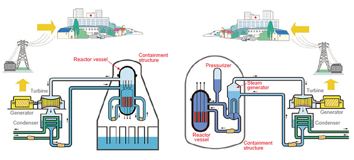

Figure 1: Nuclear power supply systems with a boiling water reactor (left) and with a pressurized water reactor (top).
[Source: Graphical Flip-chart of Nuclear & Energy Related Topics 2010 published by The Federation of Electric Power Companies of Japan].
Nuclear power, increasingly highlighted as a cleaner source of energy than fossil fuels, is seeing a brisk rise in power plant construction, particularly in Asian countries. This article introduces the special steels and welding consumables required for nuclear power plant construction.

The electricity derived from nuclear power is a form of heat energy, generated by the fission chain reaction of enriched uranium in a reactor vessel, which is transferred to a coolant that produces the steam that rotates a turbine.
There are several types of nuclear reactors, utilizing different moderators and coolants, as shown in Table 1. Figure 1 (left) shows a typical diagram of boiling water reactor (BWR) and Figure 1 (top), a pressurized water reactor (PWR). Both are light water reactors (LWR), the most common types of nuclear reactors.

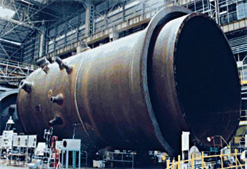

Nuclear reactors consist of reactor pressure vessels (RPV); steam generator (SG) and pressurized used only in PWRs; the piping of the primary side cooling; and the containment structure. An RPV operates at high temperatures and high pressures; hence, its components are made of heat resistant steel, namely Mn-Mo-Ni steels as per ASME Sec. II Part A (Ferrous Material Specifications). SA-533 and SA-508 are commonly used for the RPV, as well as the pressurizer and SG in PWRs. Table 3 shows the chemical and mechanical properties and the relevant JIS standards for reference.

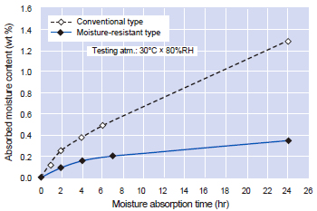

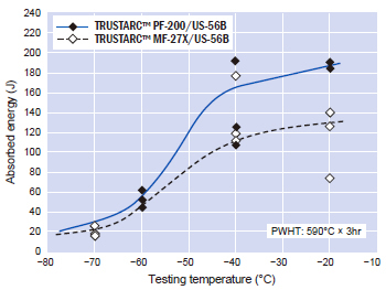

Several basic design concepts apply to welding consumables for Mn-Mo-Ni steel. One is to add Si, Mn, Ni and Mo to the weld metal in the same manner as the steel, in order to increase the quench-hardenability and to obtain the ferrite-bainite, bainite or bainite-martensite microstructure. Another is the addition of carbon. Carbon increases quench-hardenability and decreases the oxygen content in the weld metal, resulting in better notch toughness. But excessive carbon can also promote brittleness through carbide precipitation (e.g. cementite) during PWHT as well as reduce crack resistance. Therefore, the weld metal's carbon content is controlled to a slightly lower level as compared to the base metal. A third design concept is to minimize such impurities as P and Sn in order to avoid embrittlement of weld metal induced by PWHT. The increase of basicity, particularly on SAW flux, is yet another design concept, whereby the oxygen content in the weld metal is decreased, thereby obtaining high notch toughness. For example the use of TRUSTARCTM PF-200 (a bonded flux) in lieu of TRUSTARCTM MF-27X (a fused flux) obtains higher basicity and thus better notch toughness, as shown in Figure 3.
Increasing the crack resistance of the welding consumables is important to resist the residual stresses induced by welding in a thick pressure vessel. Controlling the S and C content will prevent hot cracks, and minimizing the diffusible hydrogen content will increase the resistance to cold cracks. In particular, the coverings of SMAW electrodes are designed to lessen the moisture absorption, one major source of diffusible hydrogen. As shown in Figure 4, the moisture resistant SMAW electrode offers slow moisture pickup, reducing diffusible hydrogen in the weld metal.
Figure 3: Comparison of notch toughness between fused
flux and bonded flux.
Figure 4: Comparison of moisture absorption rates between
conventional and moisture-resistant coverings.

Reactor pressure vessels require an integrated manufacturing
technique wherein base metals are matched with welding
consumables of high and consistent quality.
