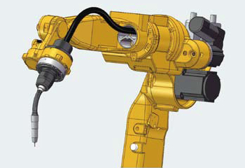

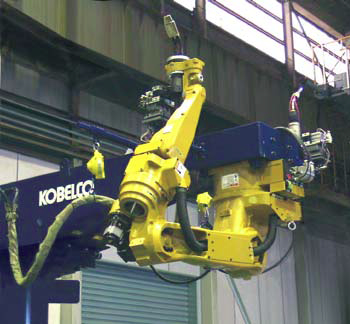

Figure 2 : ARCMAN™-GS with the cable-integrated upper arm.
(1) Cable- or torch-integrated models are available to match system requirements
Two variations are available for ARCMAN™-GS: one with cables integrated with the upper arm, as shown in Figure 2, and the other in which the torch is integrated with the wrist axis, as shown in Figure 3.
For the cable-integrated upper arm type, a wire feeder is mounted at the rear side of the upper arm; the torch cables extend from the wire feeder through the cable hole that runs alongside the upper arm. The torch body is supported at the wrist axis.
For the torch-integrated wrist axis type, the wire feeder is not mounted on the robot but is installed peripherally. The torch cables extend from the wire feeder on a cable hanger to connect to the torch body, which is supported at the wrist axis.

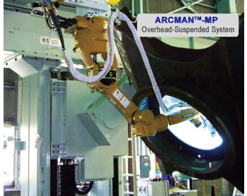

(2) Reverse-elbow positioning enables an operating envelope that is the largest in its class
In an overhead-suspended robotic system, the robot should be able to access as much of the workpiece as possible from above. Therefore, the robot’s operation envelope should be large and able to cover the area behind as well as in front of the robot.
With ARCMAN™-GS, the reverse elbow position enables the upper arm to bend behind the robot, as shown in Figure 5, expanding the motion range. This advanced function of the ARCMAN™-GS is only possible because the arm is as long as that of ARCMAN™-MP.
Figure 5 : Reverse-elbow position (left) can
prevent arm-workpiece interference with
overhead-suspended robotic system.
As illustrated in Figure 5, the reverse elbow positioning with ARCMAN™-GS enables easy access to weld lines that lie behind obstacles without interference between the arm and the workpiece. In contrast, conventional robots require complex sliding movements in order to achieve similar results and avoid interference. Because ARCMAN™-GS is capable of reaching inaccessible spots without sliding, the slider it does use is short, reducing the complexity and weight of the entire system.

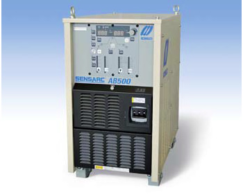

Kobe Steel’s SENSARC™ series is a lineup of welding power sources for CO2/MAG welding that meet a variety of applications. SENSARC™ AB500, for example, is a sophisticated power source exclusively for ARCMAN™ robotic welding systems for medium and heavy plate welding (see Figure 8). It is ranked as the highest quality model of the SENSARC™ series, offering multifunctional welding performance.
1. Innovations in key capabilities
SENSARC™ AB500 offers an 8 times faster arithmetic capacity and a 2.5 times higher control frequency as compared with conventional power sources, thereby establishing an innovative output waveform control by an advanced control rule.
The combined wire feeder is equipped with four driving rolls to ensure a 1.5 times stronger wire feeding force, thus increasing the maximum wire feeding speed to 30 m/min, which is 20% higher than conventional ones. In addition, the wire feeding stability has been improved by employing an encoder that detects motor rotation, a four-roll driving method, high precision digital control, and a quick response motor.
These advanced capabilities, as well as a stable and smooth arc start and easy wire feeding through wire touch sensing, shorten idle time, thereby improving the welding performance by ARCMAN™ robots. Table 2 shows the specifications for SENSARC™ AB500.

Figure 8 : SENSARC™ AB500: a multifunctional power source for ARCMAN™ welding robots.

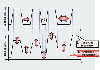

Through persistent research and development on the tandem arc welding method, an innovative welding current output control has been developed and applied to the present power source. With this technique, two tandem pulsed arcs are controlled in such a way that the pulse peak and base currents are synchronized between the two arcs, thereby increasing arc stability and reducing spatter.
With SENSARC™ AB500, the arc length of the trailing electrode is optimized by the newly developed synchronous amplitude modulation control that increases or decreases the pulse peak and base current as shown in Figure 9.
Figure 9 : Conceptual diagram of synchronous amplitude modulation control.
modulation control.
With this mechanism, SENSARC™ AB500 allows a wider range of welding parameters because the arc lengths of both leading and trailing electrodes are controlled adequately, preventing disturbance effects and maintaining the constant arc lengths. Furthermore, unlike conventional power sources, a change in the leading electrode’s welding parameter does not affect that of the trailing electrode; hence, welding parameters can easily be adjusted.

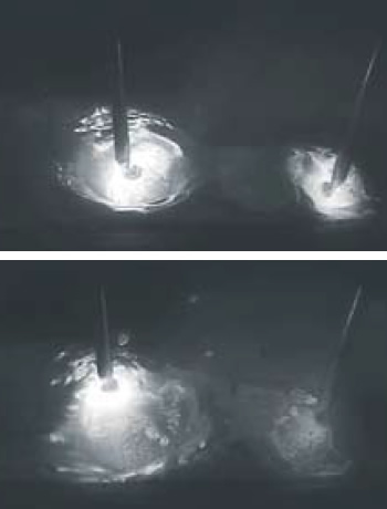

To obtain a stable arc and sound weld in one-pool tandem arc welding, control over the molten metal bulge generated between the two electrodes in the weld pool is essential.
With conventional power sources, when one electrode encounters a disturbance, the arc fluctuates, causing changes in arc length that affect the arc force, and this can cause the molten metal bulge to become unstable. And the destabilized bulge of molten metal affects the arc force of the other electrode, thereby causing an unstable arc.
By contrast, SENSARC™ AB500 can maintain stable arcs and cancel disturbances with the advanced high quality load-characteristic control.
Figure 10 : One-pool tandem arc welding with (top)/without (bottom) high quality load-characteristic control.
In Figure 10, the top picture shows a stable bulge of molten metal generated between the two electrodes by means of high quality load-characteristic control, thereby creating stable and low spatter arcs. In contrast, when load-characteristic control is not used, as shown in the bottom picture, the bulge fluctuates in shape, causing unstable arcs with much spatter.

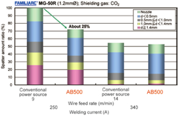

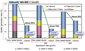

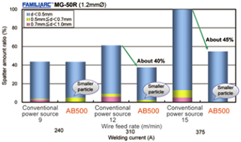

In pulsed MAG welding with solid wire for mild steel, arc stability and spatter generation can be improved (Figure 12) with some new technologies. For example, the immediate load-characteristic control as well as the high-quality disturbance-cancellation control can remove the instantaneous fluctuation associated with the fluctuation at the current-carrying point and the arc generation point on a welding wire, thereby reducing excessive arc force fluctuation.
With such advanced technologies, SENSARC™ AB500 can reduce the spatter generation ratio by up to 45% and spatter size, even at a high welding current of 300 A or more as is used commonly in the medium and heavy plate welding.
In CO2/MAG welding in the medium welding current range, where large spatter particles tend to be generated, the advanced technology for suppression of molten droplet vibration can reduce the spatter generation ratio by as much as 25% in comparison with a conventional power source as shown in Figure 13. With this technology, excessive droplet growth and vibration are restrained by changing the operating characteristics according to the amount of droplet growth. As a result, it prevents droplets from scattering and reduces the spatter generation ratio.
Figure 12 : Comparison of spatter generation ratio between SENSARC™ AB500 and conventional power source by pulsed MAG welding.
pulsed MAG welding.
Figure 13 : Comparison of spatter generation ratio between SENSARC™ AB500 and conventional power source by CO<small>2</small> welding.
Figure 13 : Comparison of spatter generation ratio between SENSARC™ AB500 and conventional power source by CO2 welding.
