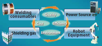

A solution is the act of or capability for solving problems. When it comes to a welding solution, it means solving customers’welding problems. In the course of helping clients solve problems and addressing their requests, Kobe Steel, Ltd. has been able to develop its highly reputed range of welding consumables, robotic welding systems as well as welding power sources and processes. The basis of all welding solutions arises from the users’needs, as shown in Figure 1.
In the past, however, a welding consumable or a robotic welding system was regarded as the endpoint of welding product development, and it would be up to the customer to adopt the product or combine one final product with another. The total welding solution as envisaged by Kobe Steel seeks to define the entire welding procedure, matching the welding process with the appropriate welding consumable, shielding gas, and power source. Ultimately the goal is to raise the quality of welded structures by improving the efficiency of the welding procedure and reducing costs (Figure 2).
Kobe Steel, Ltd. is one of the few companies in the world that develops and manufactures welding consumables, robotic welding systems and power sources. This enables Kobe Steel to offer its original welding consumables in combination with the most appropriate welding procedures. In this special edition of Kobelco Welding Today, we wish to introduce three new total welding solutions: MX-MIG process, J-Solution™ Zn and Ultra High Current MAG Welding.
Figure 1: Welding solution cycle
