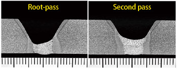

Figures 6 and 7 show face side bead appearance after root and second passes and back bead appearance after root-pass welding in 1G and 3G (uphill) positions by NO65G (2.4mm dia.), respectively. Figures 8 and 9 exhibit macro-structures of root-pass and second-pass welding in 1G and 3G (uphill) positions, respectively. The groove configuration was of single 60°V, with a root gap of 3.0-3.5mm. The welding conditions were 110A-12V for root-pass without back-shielding and 160A-13V for second pass welding, respectively.
Figure 6: Bead appearance in 1G position
Figure 7: Bead appearance in 3G (uphill) position
Figure 8: Macro-structure in 1G position
Figure 9: Macro-structure in 3G (uphill) position
