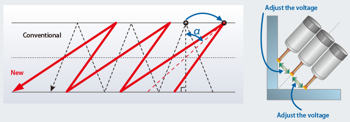

2.3.1 Efficient horizontal fillet welding
A new back-and-forth weaving pattern along with conventional right-left weaving (see Figure 5), used in combination with a function that sets arc voltage at both vertical and flat member sides independently, enables a robot to achieve 6 mm leg length with a 1.2 mm dia. solid wire, current as high as 450 amperes, and 700 mm/min speed, while maintaining high quality welds without undercut or overlap. Such work can be applied to welding of small-sized construction machinery, agricultural machinery and truck beds.
Figure 6 compares the bead shapes obtained when welded by the new weaving function described above or by the conventional method.
While similar horizontal fillet welding can be carried out by the conventional ARCMAN™ series robotic welding systems by utilizing the arc sensor function, slower welding speeds are required (applicable leg length from 4 to 8 mm).
Figure 5 : Horizontal fillet welding with high welding speed
Figure 6 : Results of horizontal fillet welding at high welding speed
